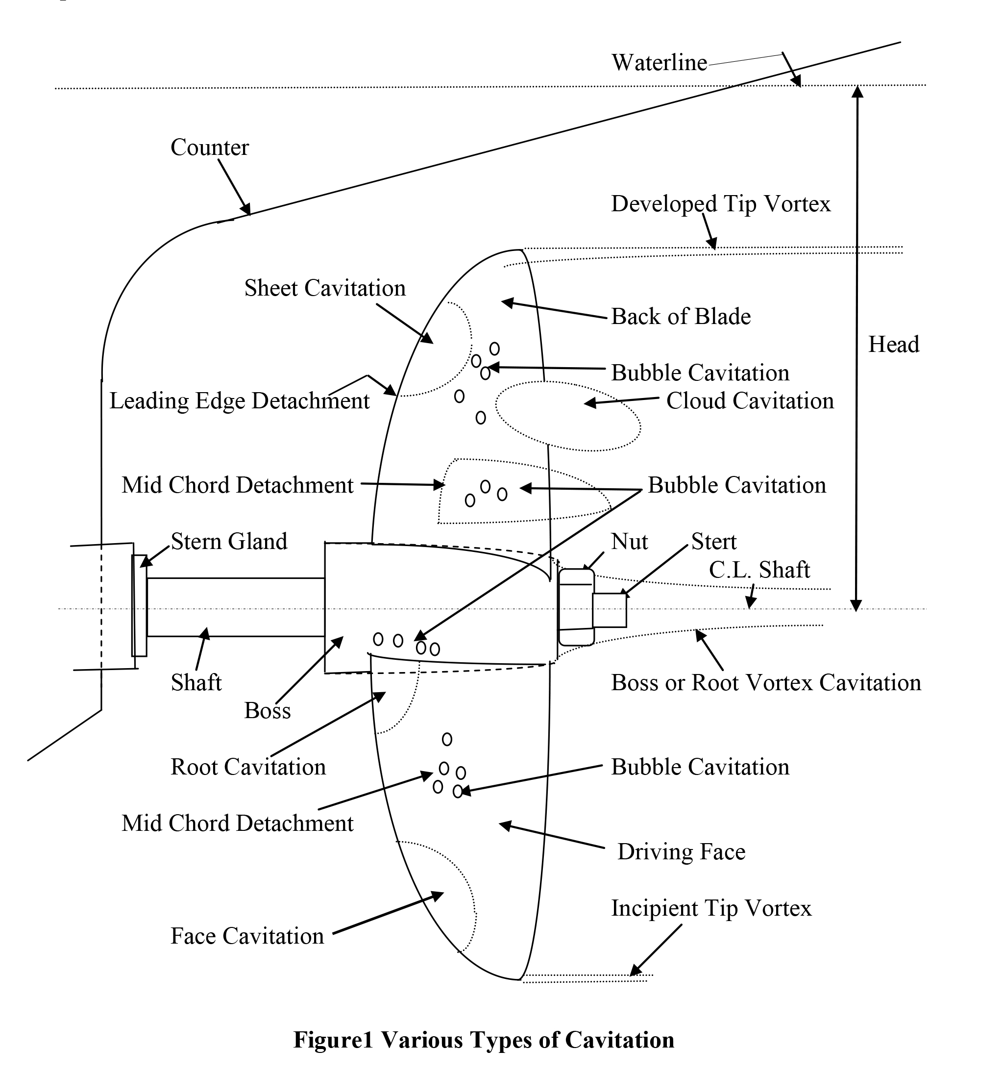

### Part (a): Effect of Cavitation on Propeller Blades
Cavitation is a complex hydro-dynamic phenomenon involving the formation and subsequent collapse of vapor-filled cavities (bubbles) in a liquid. It occurs when the local static pressure drops below the liquid's vapor pressure. On a propeller, this is most common on the low-pressure suction side (back) of the blades, particularly near the leading edge and blade tips where water velocity is highest.
**Mechanism of Cavitation:**
1. **Bubble Formation:** As a propeller blade rotates at high speed, the water flowing over the curved suction face accelerates. In accordance with Bernoulli's principle, this increase in velocity leads to a significant drop in local pressure.
