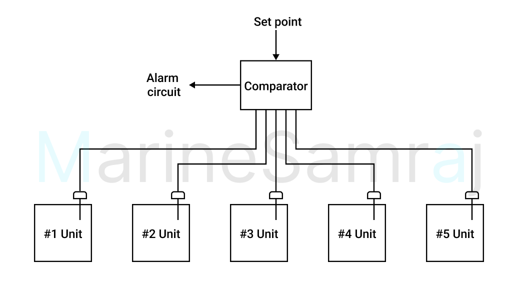

A diesel generator when fitted in a machinery space which is periodically unmanned may be equipped with monitoring alarms of the exhaust temperatures. Discuss the relative merits of:
(a) Individual cylinder maximum exhaust temperature alarms;
(b) Individual cylinder maximum and minimum exhaust temperature alarms;
(c) Individual cylinder maximum exhaust temperature alarm and an alarm for any two cylinders exhaust temperatures deviating more than 35°C.
(d) Explain how arrangement (c) can be provided for.
(a) Individual cylinder maximum exhaust temperature alarms:
An alarm for the maximum exhaust temperature in each cylinder is beneficial because it can provide an early indication of localized problems specific to an individual cylinder. Common causes include:
Blocked or sticking fuel injector.
Dripping injector nozzle causing afterburning.
