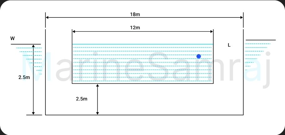

Q7 (a) Explain how an increase of draught and of displacement influence rolling. (6) (b) A pontoon has a constant cross-section as shown in Fig. Given below. The metacentric height is 2.5 m. Find the height of the centre of gravity above the keel. (10)
