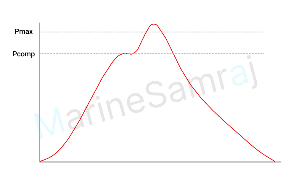

A set of indicator diagrams cards has been taken for a main diesel engine. Analyze with reference to the following conditions and suggest corrective action in each case:
(a) Higher peak pressure with normal compression pressure.
(b) Normal peak pressure with lower compression pressure.
(c) Higher peak pressure with higher compression pressure.
(d) Normal compression pressure with fluctuating pressure line during expansion stroke after ignition.
(a) The maximum pressure is higher
Pcomp = Normal
Pmax = High
Conclusion = Early injection
