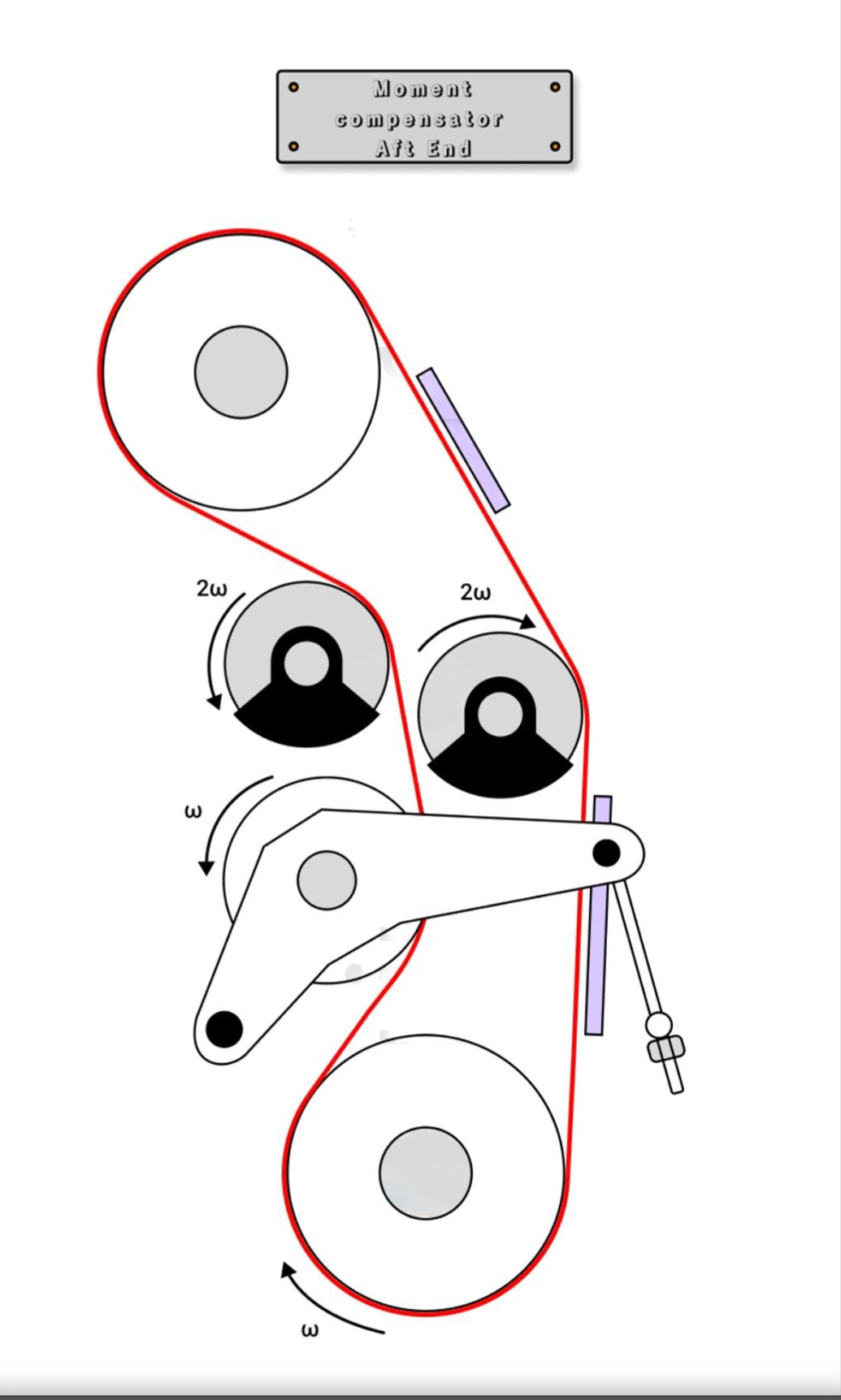

Q6. a.)Explain the need for a moment compensator in large two-stroke marine engines. With the help of a neat sketch, describe the construction and working principle of a moment compensator. (10) b.)Discuss the consequences of failure or incorrect functioning of the moment compensator in a Two-stroke engine. What checks and maintenance practices are recommended to ensure its reliability? (6)
### Part A: Moment Compensator in Large Two-Stroke Engines
#### 1. Need for a Moment Compensator
Large, slow-speed, two-stroke marine diesel engines, due to their long stroke and heavy reciprocating masses (piston, piston rod, crosshead, and a portion of the connecting rod), generate significant inertia forces. While these forces can be balanced to a degree, they create unbalanced moments that cause the engine to vibrate.
* **Primary and Secondary Forces:** The reciprocating motion of the piston assembly creates both primary (once per revolution) and secondary (twice per revolution) inertia forces along the cylinder axis.
