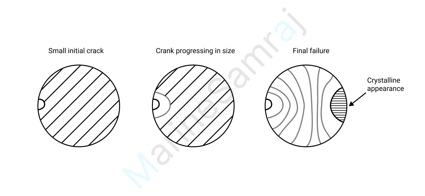

(a) Fatigue is the process leading to localized structural damage in materials subjected to cyclic loading.
Fatigue failure can occur even when stress levels are below the ultimate tensile strength of the material.
It primarily results from repetitive cyclic loads, causing microscopic crack formation and growth over time until the component fails.
