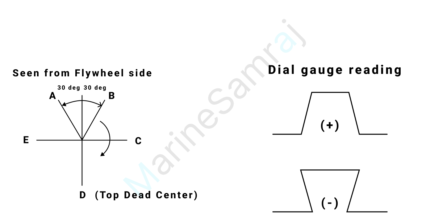

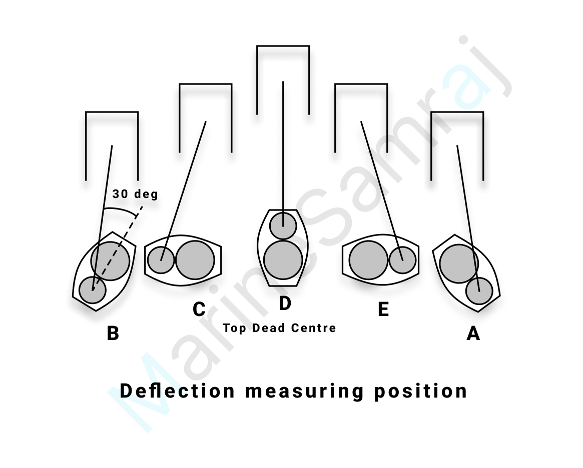

(b) How would you check the deflections by means of a dial gauge through one revolution of the shaft? (4)

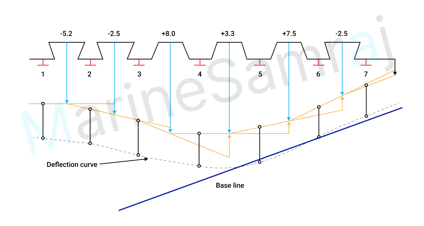

(c) How are the readings obtained interpreted? (4)
