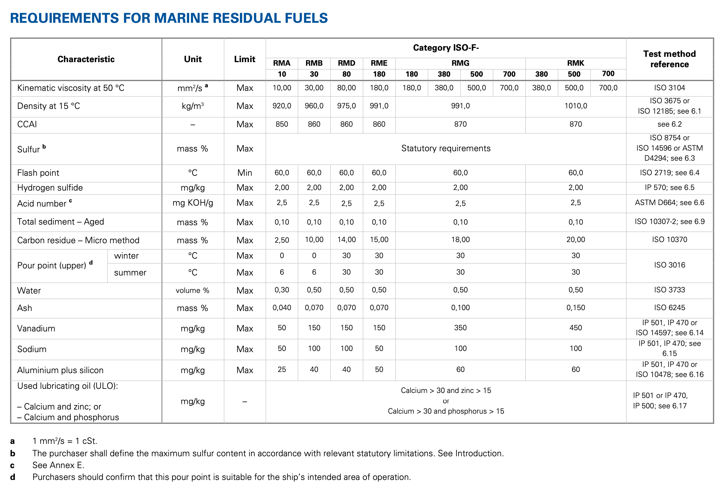

(b) Recognised fuel standards ISO 8217-2017 for Marine residual fuel RMG 380
