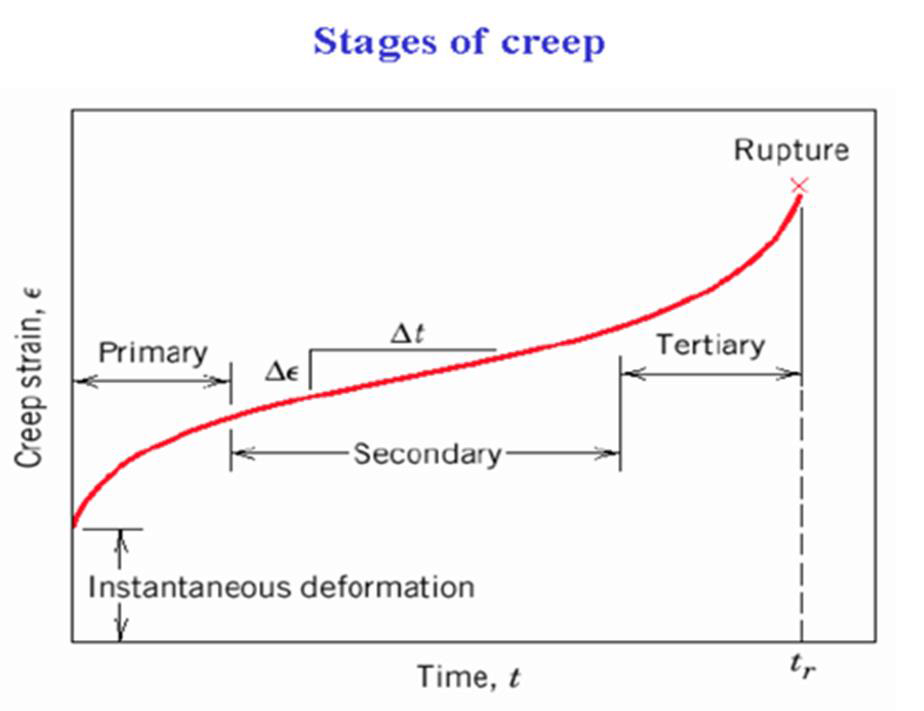

Creep is defined as the time-dependent, permanent plastic deformation of a material subjected to a constant stress (or load) at elevated temperatures. Critically, this deformation occurs at stress levels significantly below the material's yield strength. It is a slow, continuous process that can eventually lead to component failure or rupture over an extended service life.
#### Stages of Creep
