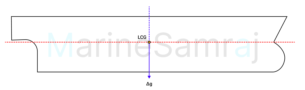

(a) Longitudinal Centre of Gravity (LCG):
The Longitudinal Centre of Gravity (LCG) is the point along the length of the vessel where the total weight of the ship is considered to act vertically downward.
It represents the balance point of the ship's weight distribution and is measured as a distance forward or aft of the midship.

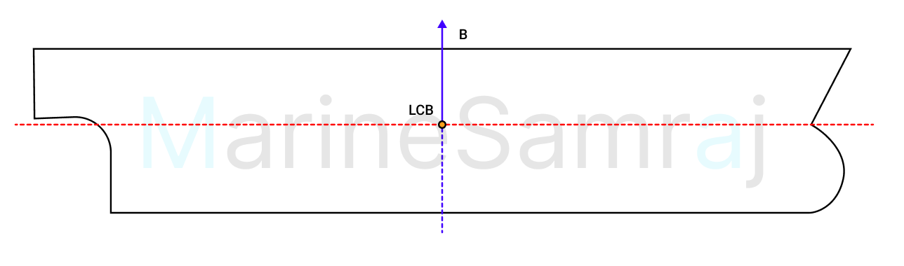

Longitudinal Centre of Buoyancy (LCB):
