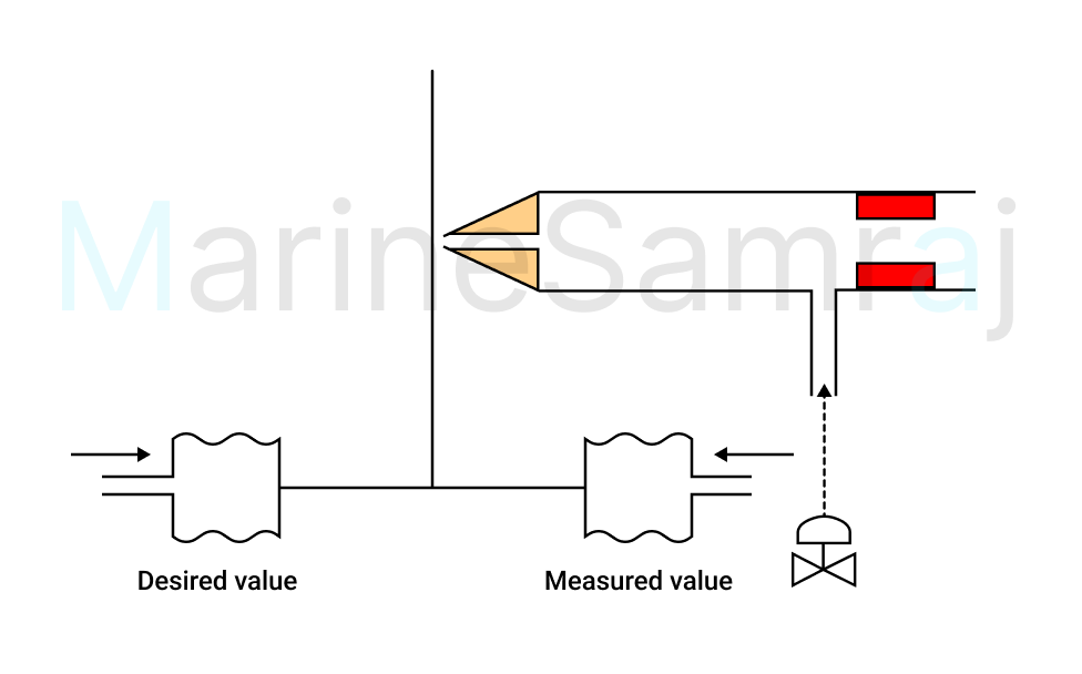

(b) Sketch and describe a simple pneumatic proportional controller. (4)
