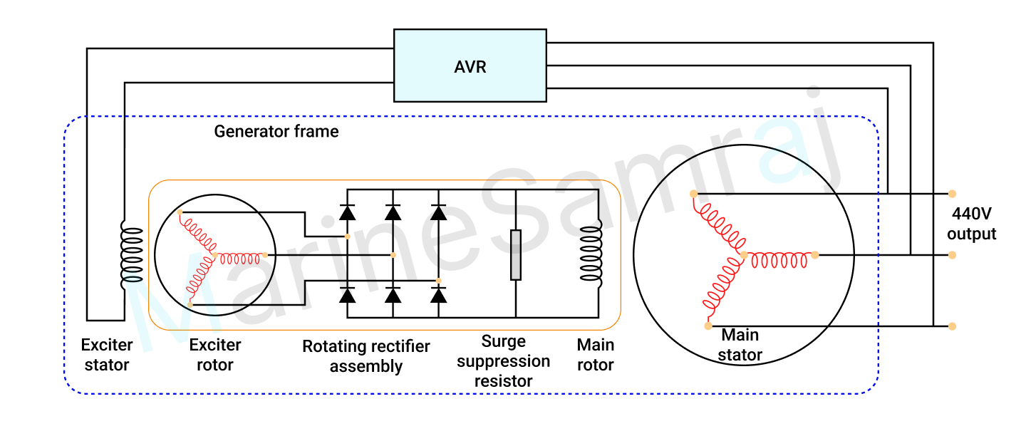

(a) Describe a brushless alternator with a.c. exciter and static A.V.R. (8)
(b) State the output voltage characteristics for this type of machine. (8)
A brushless alternator is a type of electrical generator that produces alternating current (AC) without the need for brushes and commutators.
Rotor: Instead of using brushes and a commutator, a brushless alternator has a rotor with permanent magnets or electromagnets. These magnets generate a rotating magnetic field when electricity is supplied to them.
Stator: The stator consists of coils of wire arranged around the rotor. As the magnetic field of the rotor rotates, it induces an alternating current in the stator windings through electromagnetic induction.
Rectifier: The alternating current produced in the stator windings is then converted into direct current (DC) by a rectifier assembly, typically consisting of diodes. This DC is necessary for the excitation of the rotor's magnets.
