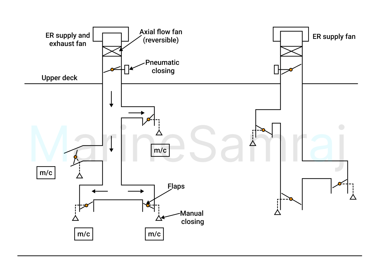

Forced ventilation for Machinery space:

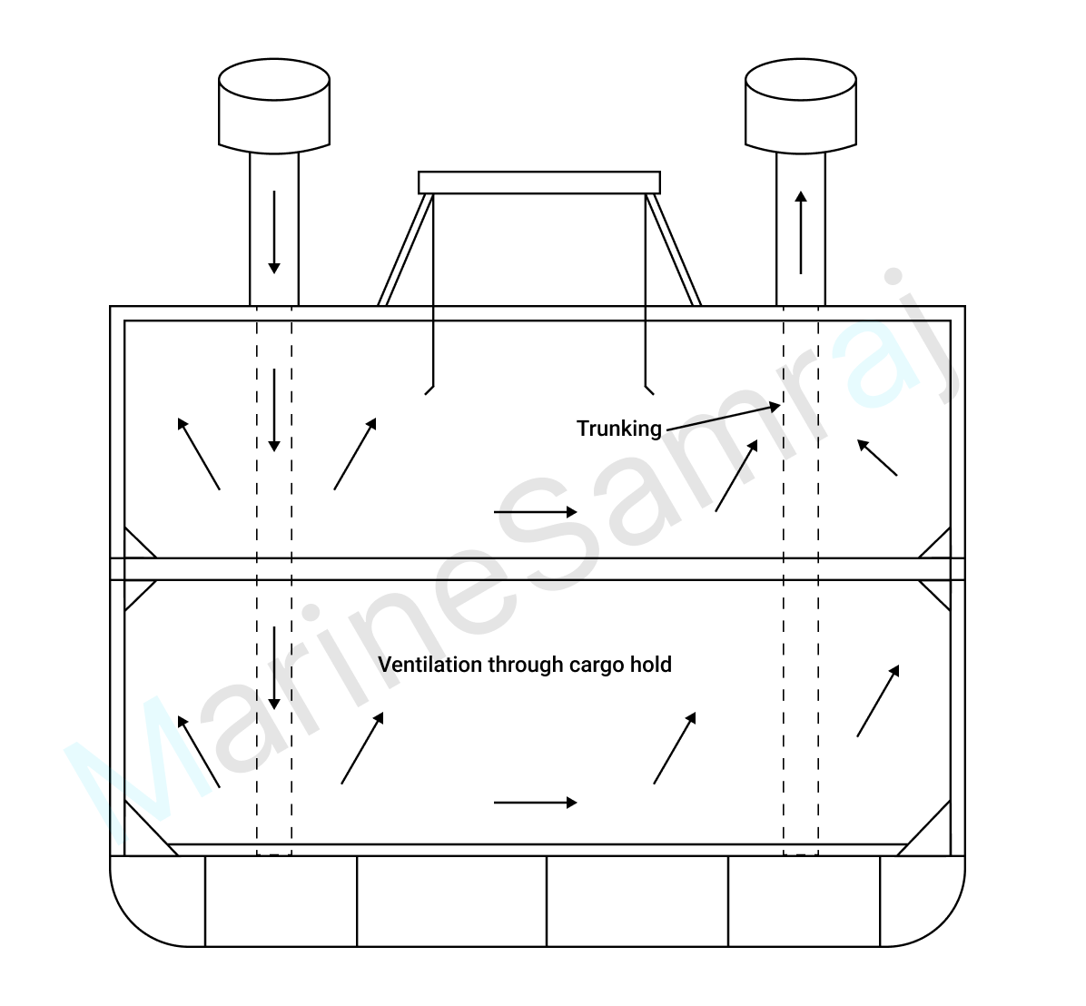

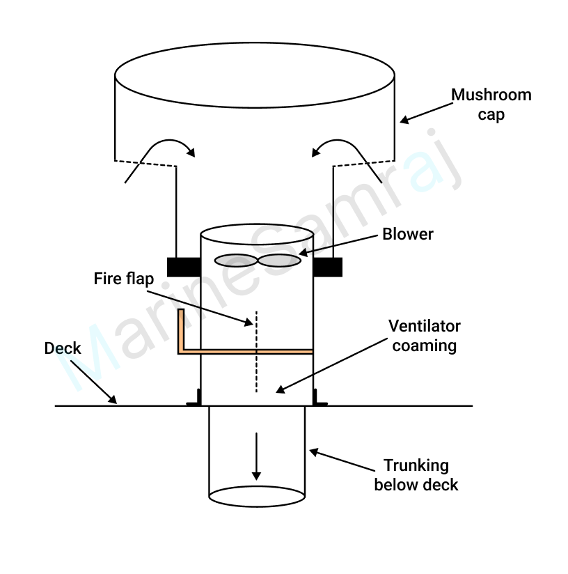

Cargo hatch Mechanical ventilation:
Mechanical ventilation is achieved by using fans to circulate air through the hold. A mechanical ventilation system may have fans that are protected by covers.

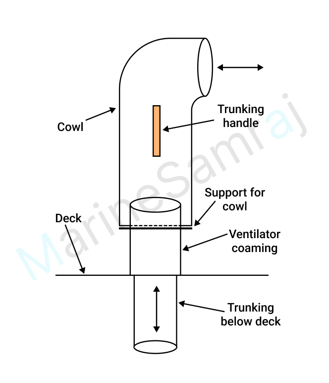

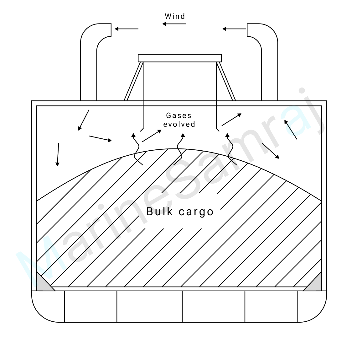

Cargo hatch Natural ventilation:
