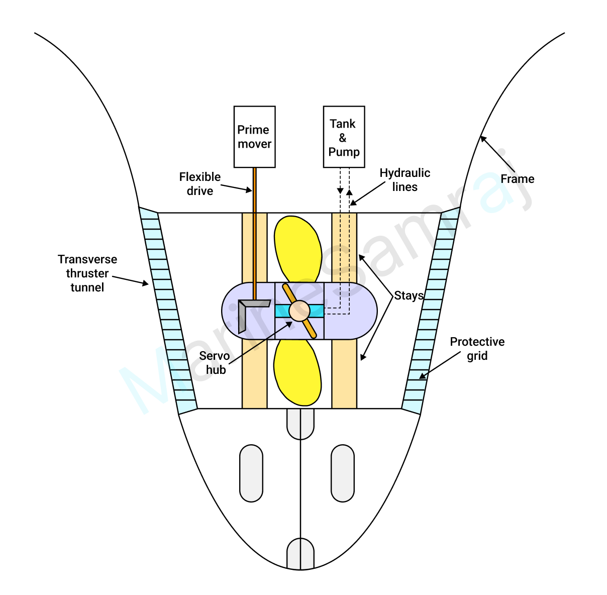

### (a) Transverse Bow Thrust Unit (Controllable Pitch Propeller)
A transverse bow thrust unit is a propulsion device installed in the bow of a ship, running athwartships, to provide lateral thrust. This greatly enhances the vessel's manoeuvrability at low speeds, particularly during docking, undocking, and navigating in confined waters. The controllable pitch propeller (CPP) variant allows for precise and rapid control of thrust magnitude and direction without changing the prime mover's speed or direction of rotation.
**Construction and Operation:**
* **Tunnel:** The core of the unit is a cylindrical tunnel running transversely through the vessel's forepeak, well below the waterline. The tunnel ends are faired into the hull to ensure smooth water flow and minimize drag. Protective grids are fitted at both ends to prevent the ingress of foreign objects.
