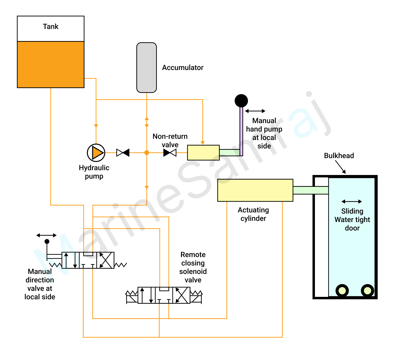

(a) Operating Mechanism for a Watertight Door
In vessels with a large number of watertight bulkhead plates and access doors located below the waterline, a powered operating system is essential. Various systems are employed, primarily electrical and hydraulic types. A circuit diagram for a hydraulically operated system is commonly provided.
Hydraulic System Operation:
At each door, a motor-driven pump supplies oil at a pressure of 48 bar to a double-acting cylinder via a control valve .
