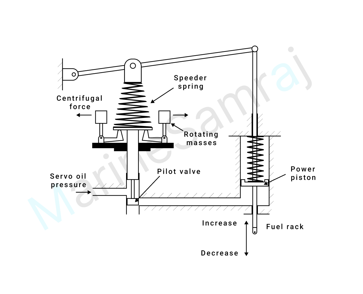

(a) Why flyweights are driven at a higher rotational speed than the engine
The operation of flyweights in a governor relies on the principle of centrifugal force, which governs their outward movement from the centerline. The centrifugal force is given by:
$$F=m\omega^2r$$
Where:
