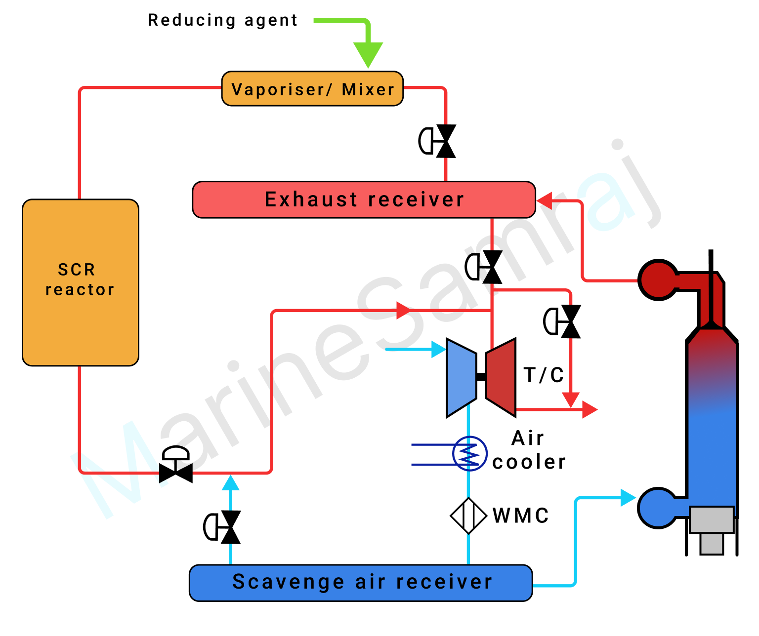

(a) Describe, with the aid of a sketch, an external system for reducing engine NOx emission, explaining the chemistry of the process. (8)

### (a) Selective Catalytic Reduction (SCR) System
#### Concept and Principle
Selective Catalytic Reduction (SCR) is an exhaust gas after-treatment technology used to reduce Nitrogen Oxides (NOx) emissions from marine diesel engines to comply with MARPOL Annex VI Tier III regulations. The system injects a reducing agent, typically an aqueous urea solution (also known as AdBlue or AUS 32), into the hot exhaust gas stream upstream of a catalyst. The urea decomposes into ammonia, which then reacts with NOx on the catalyst surface to convert it into harmless diatomic nitrogen (N₂) and water (H₂O).
