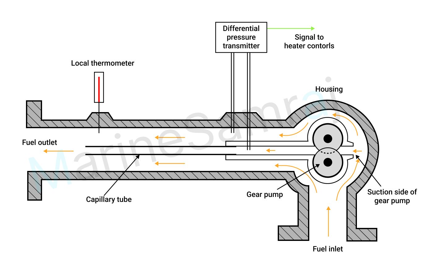

(a) The sketch below illustrates the main engine ancillary equipment used for automatic monitoring and regulation of fuel viscosity.
Viscotherm with Differential Pressure (DP) Transmitter:
The viscotherm consists of a capillary tube connected to the discharge side of a gear pump driven by an electric motor.
A DP transmitter measures the pressure difference in the capillary tube, which is directly proportional to the viscosity of the fuel oil.
