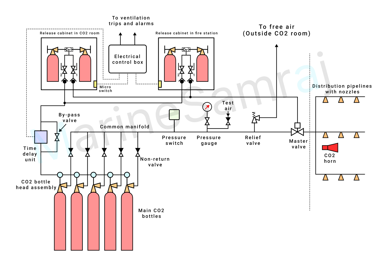

Describe with the aid of a sketch the release arrangement for a machinery space fixed fire-fighting installation using CO2. State in your answer any special need for rapid delivery of the gas and the time permitted for discharge

### (a) CO2 Release Arrangement, Rapid Delivery, and Discharge Time
#### Release Arrangement
The machinery space fixed fire-fighting CO2 installation is a total flooding system designed to extinguish fires by displacing oxygen. The system is operated from a dedicated, secure CO2 room located outside the protected machinery space.
**1. Storage:**
