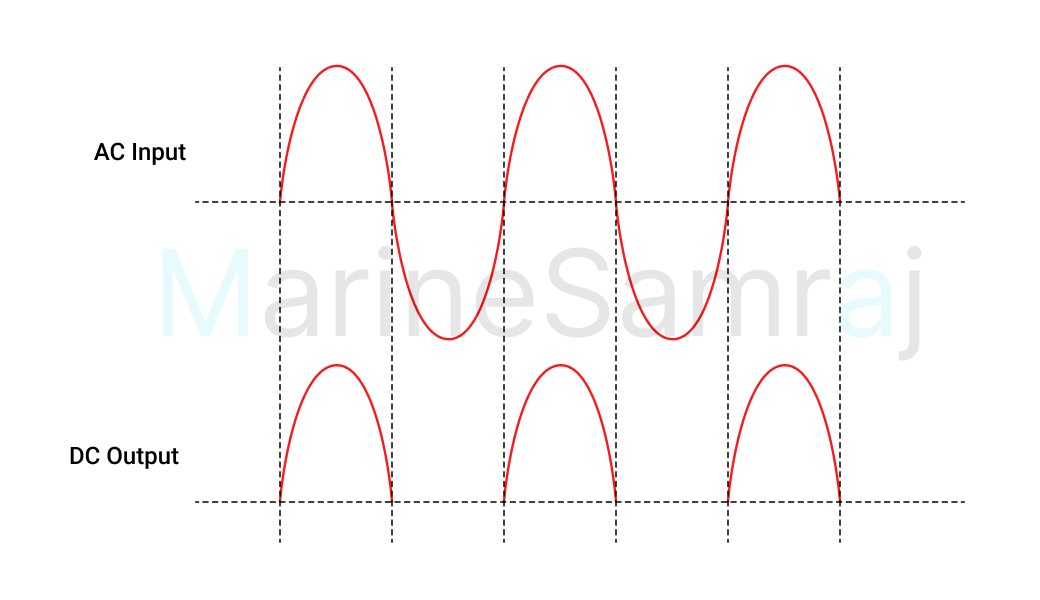

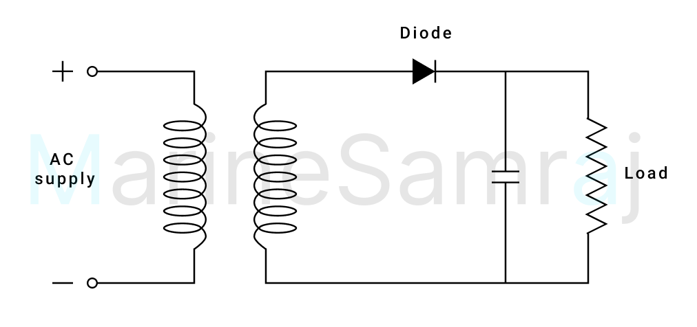

(a) Rectifier Circuit
Converts AC (Alternating Current) into DC (Direct Current).
Input: AC signal.
Output: DC signal.
