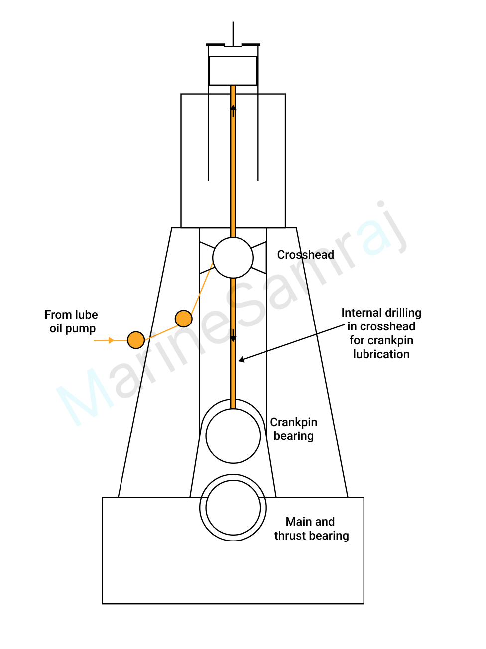

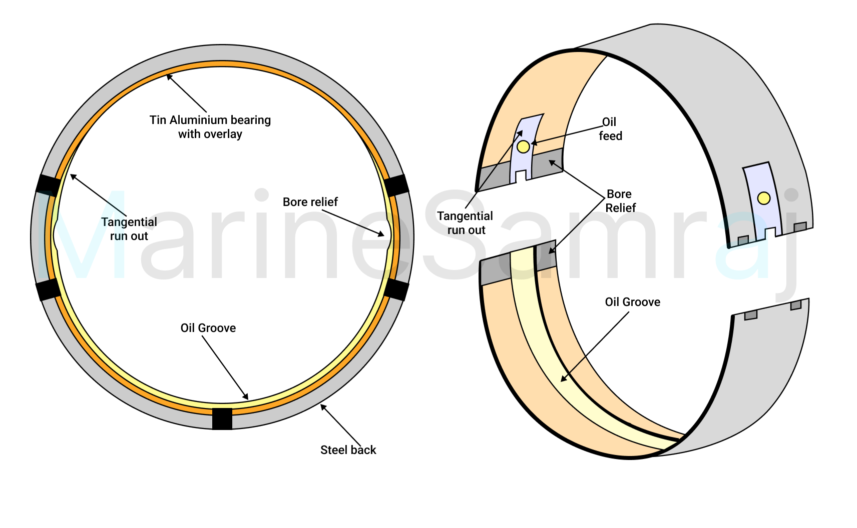

Discuss the consequences of failure to maintain correct clearances in the case of main diesel engine crankshaft and bottom end bearings: Sketch a bottom end bearing paying particular attention to the arrangement of ensuring uninterrupted flow of oil to the top end bearing.
