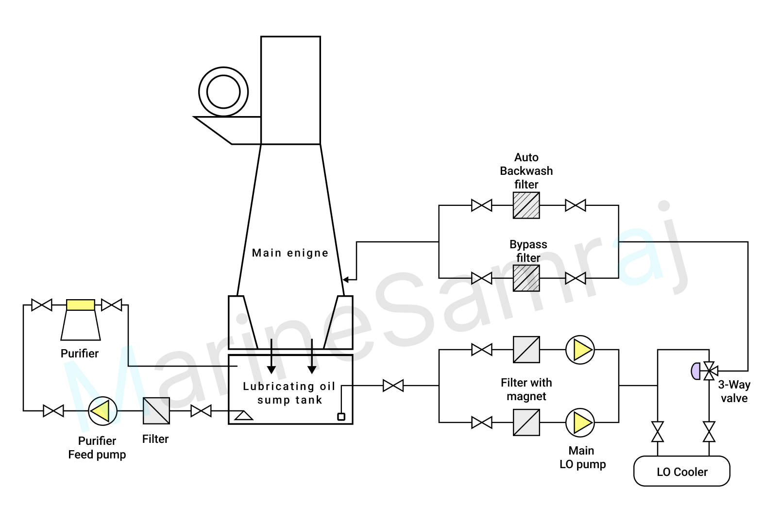

Discuss the importance and methods employed in maintaining the quality of lubricating oils in main and auxiliary diesel engines. As a second engineer. what strategy you would employ to ensure that the main engine crankcase oil quality is ensured.
Methods adopted to maintain the quality of crankcase oil:
(i) Filtration system
The filtration system consists of 3 filters, as shown in the above figure:
Suction filter with a magnet before the LO pump
