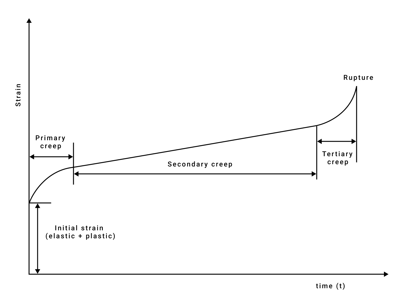

(b) Define creep and specify the conditions under which it occurs? (8)
