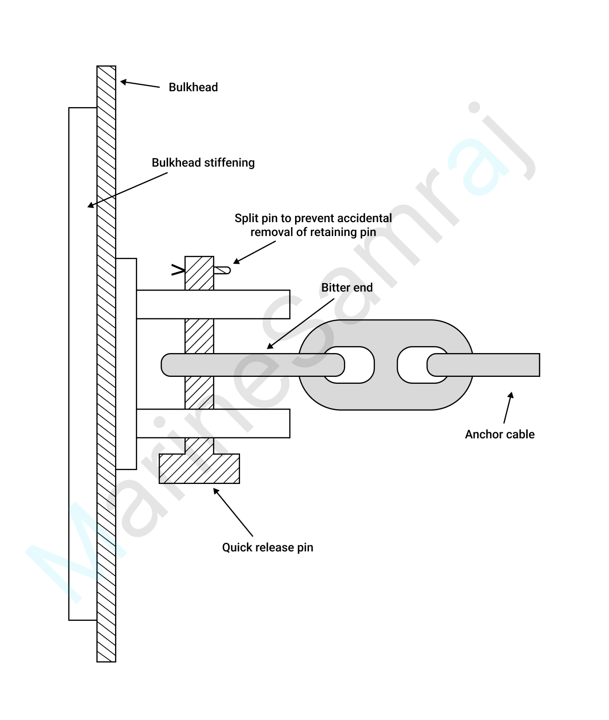

(c) Show by means of a sketch how the anchor cable is attached to the ship. (4)
