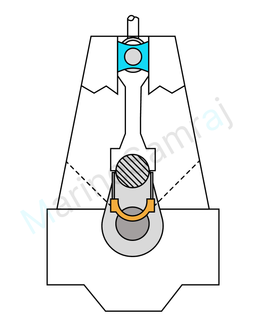

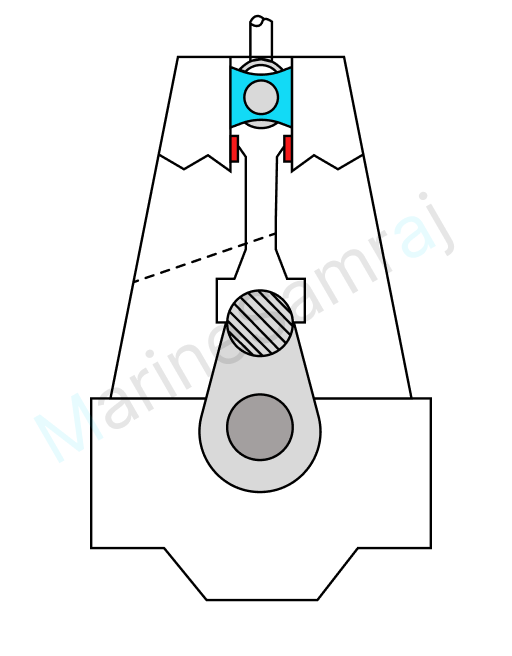

(a) If the top end bearing is wiped and the pin is badly scored, the engine must be modified to allow the vessel to limp to port. The primary action is removing the affected cylinder's connecting rod and suspending the piston, thus effectively isolating the seized unit. The following procedure is to be followed:
The lower half of the bottom end bearing is secured using a chain block to prevent it from falling into the crankcase during disassembly.

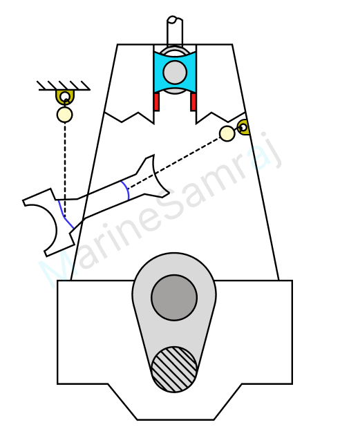

The hydraulic nut securing the lower half of the bottom end bearing is opened, and the bearing is carefully removed from the crankcase.
The connecting rod is then secured using a chain block.
