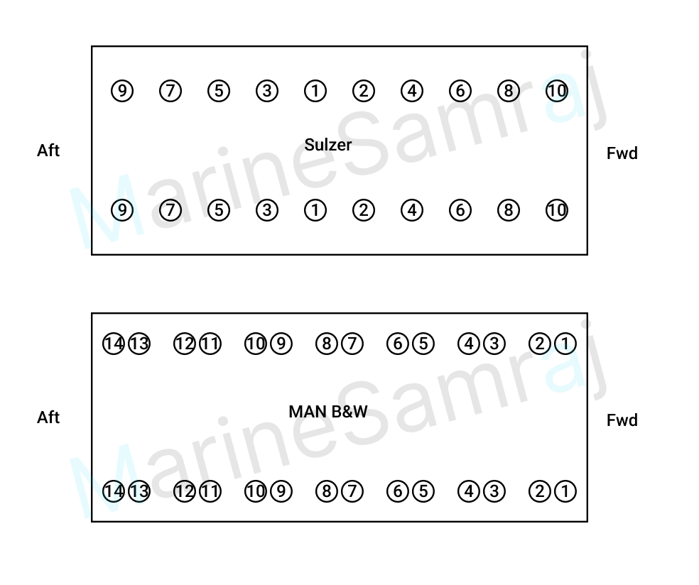

(b) Explain how correct tension is restored and the risk of future slackness minimized. (5)
