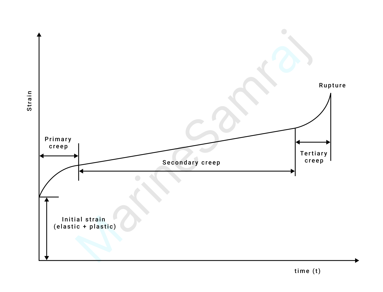

Creep:
Creep is the time-dependent permanent deformation of a material under sustained stress at elevated temperatures. It occurs at stresses significantly below the material's yield strength. The rate of creep depends on material properties, temperature, time under load, and the applied stress. Creep progresses in three stages: primary (decreasing rate), secondary (constant rate), and tertiary (rapidly increasing rate leading to failure). An example is the creep of a turbine blade, causing it to contact the casing and fail.
