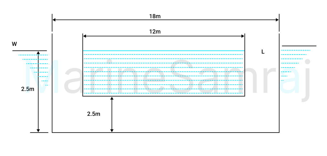

(b) A pontoon has a constant cross-section as shown in Fig. given below. The metacentric height is 2.5m. Find the height of the centre of gravity above the keel (10)
Fig. for part (b)
