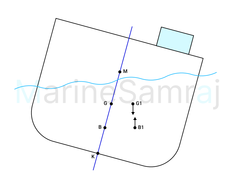

(a) Distinguishing between List and Loll:
1. List is caused by Uneven distribution of weight within the ship. List will have the below conditions:
GM is positive (GM > 0).
The centre of gravity (G) is off-centre.
