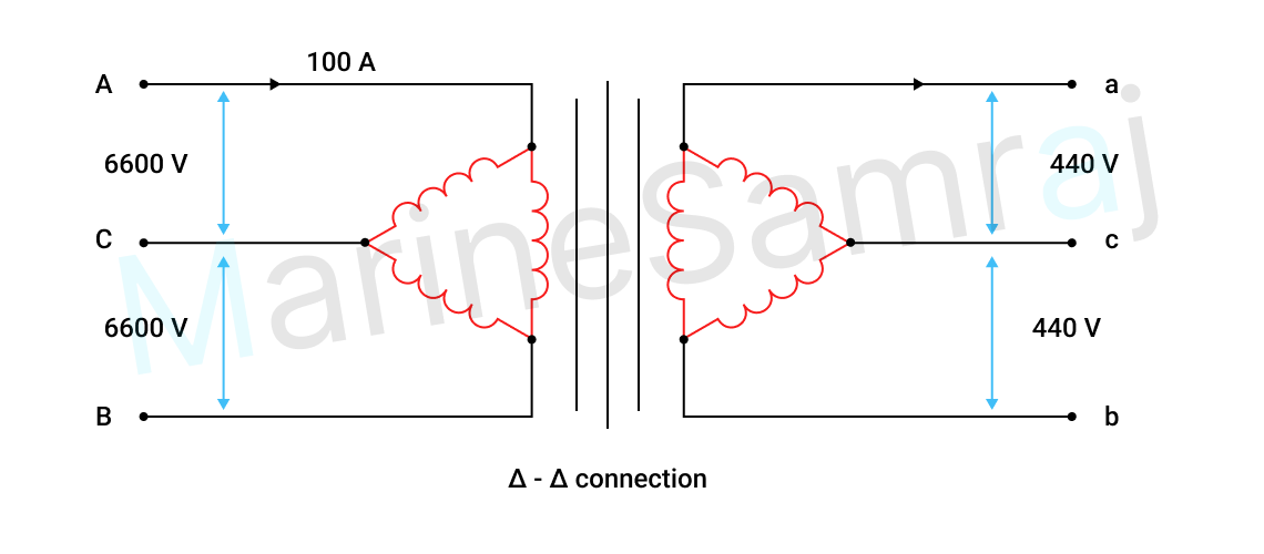

(b) In a container ship, a 3-ph, delta/ delta connected 6600/440 V, 60 Hz transformer is feeding AMP supply from shore to 440 Volt switchboard Transformer primary current takes a line current of 100 amp, when secondary Load of 0.8 Lagging p.f. is connected. Determine each coil- current and KW output of transformer. (8)
(b)
Phase voltage on primary = line voltage on primary $= 6600V$
Phase voltage on secondary = line voltage on secondary $= 440V$
