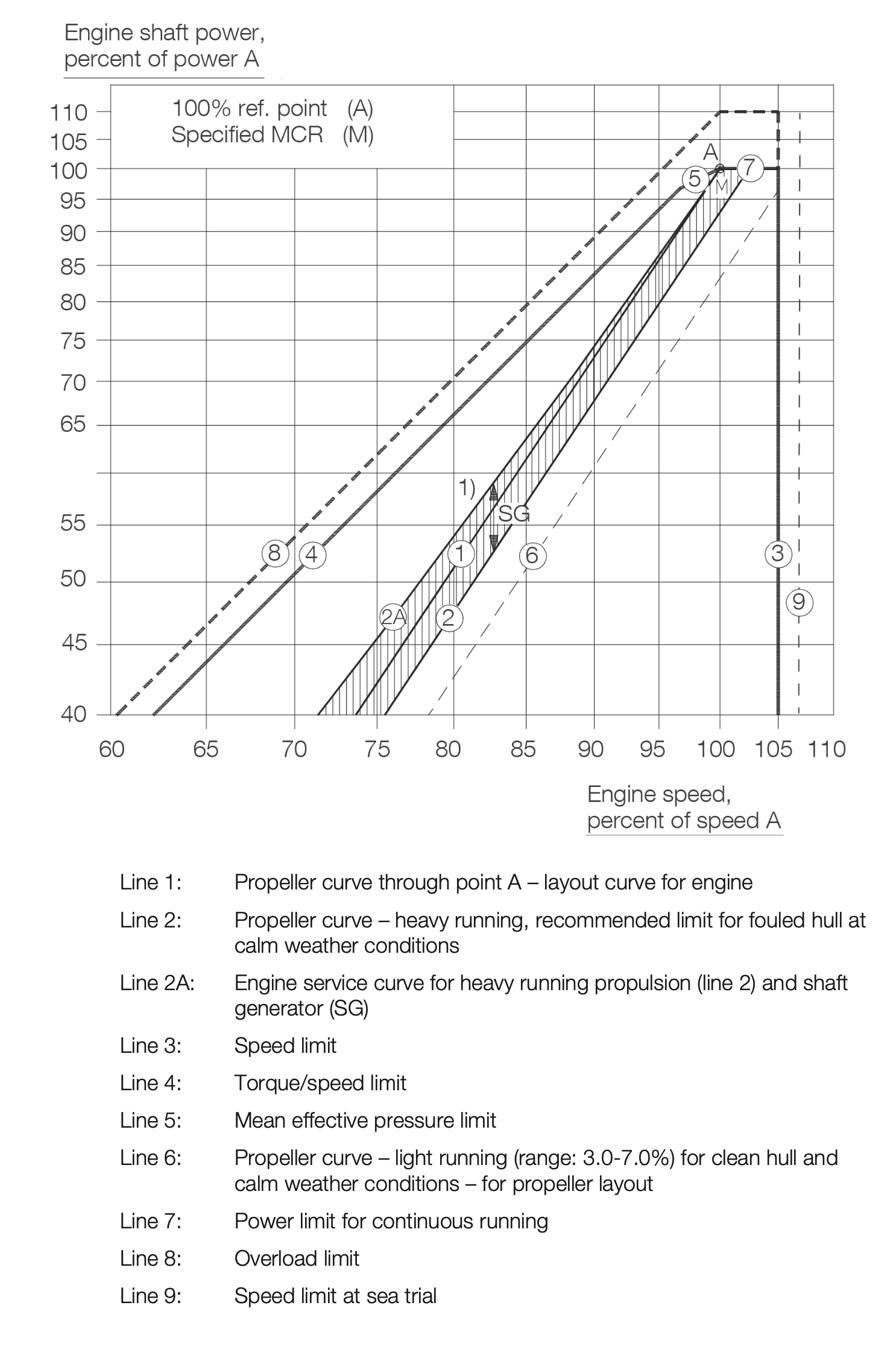

(a) Explain the significance of propeller curves. Enumerate the safety margins in relation to the propeller operations. (8)

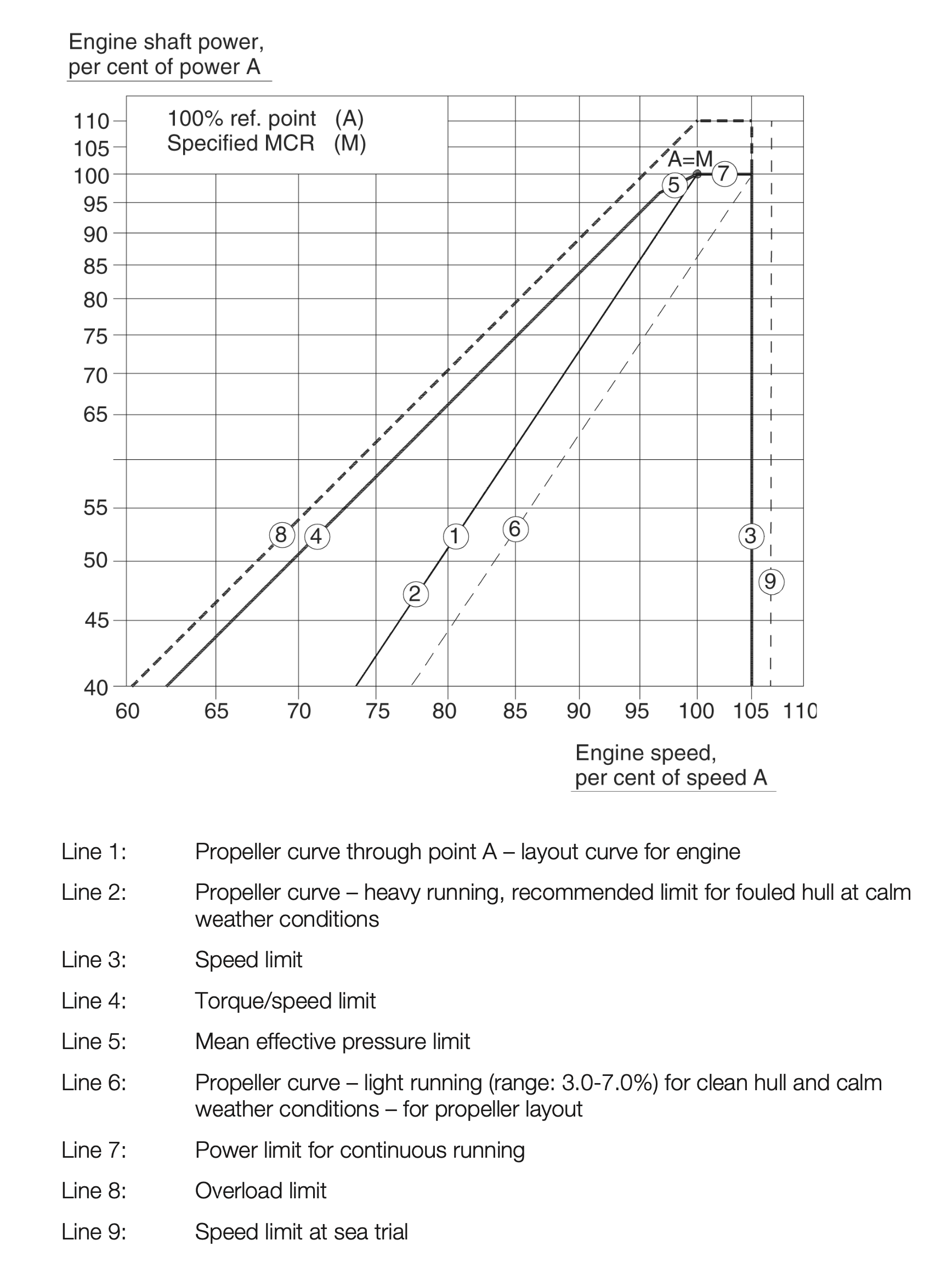

(b) Using typical engine power versus engine speed diagram and propeller demand curves, discuss the relation between the maximum rated output of the propulsion plant and the power for which the propeller is designed. (8)
### (a) Significance of Propeller Curves and Safety Margins
#### Significance of Propeller Curves
A propeller curve is a graphical representation of the power required to drive a propeller at a given rotational speed (RPM). It is plotted on the engine's load diagram (Power vs. RPM) and is fundamental to understanding and managing the propulsion plant's performance. Its significance lies in several key areas:
* **Engine Loading Characterization**: The curve shows how the engine will be loaded by the propeller under various conditions. The relationship is approximately cubic, where power is proportional to the cube of the speed ($$ P \propto N^3 $$).
