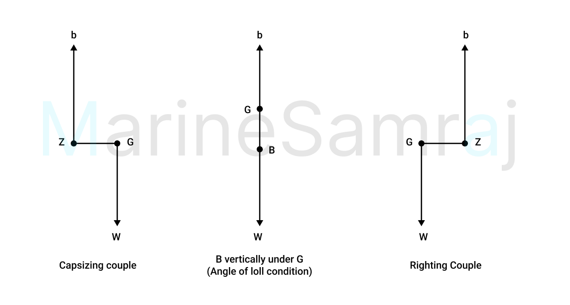

Angle of Loll refers to the angle of heel at which a ship with negative GM (i.e., unstable equilibrium) comes to rest due to the movement of the center of buoyancy beneath the center of gravity. When a ship with negative metacentric height heels to one side—usually due to an external force like wind or wave action—the center of buoyancy moves toward the lower side. As the heel increases, the center of buoyancy continues to shift outward, and if it moves directly under the center of gravity (G), the capsizing moment is momentarily nullified. The angle at which this occurs is called the angle of loll .
Dangers it poses to a vessel:
The ship oscillates about the angle of loll rather than about the upright vertical, indicating unstable equilibrium.
If the center of buoyancy does not move sufficiently to position itself vertically beneath G, the vessel lacks restoring force and may capsize .
