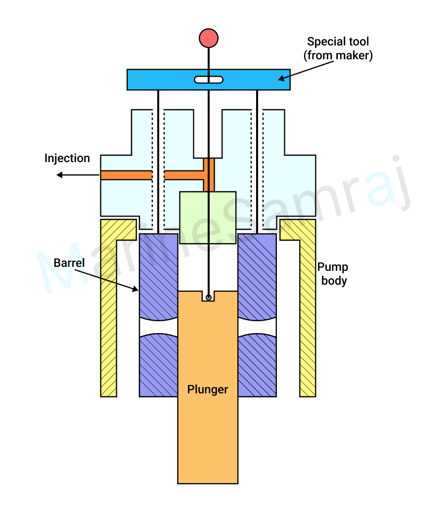

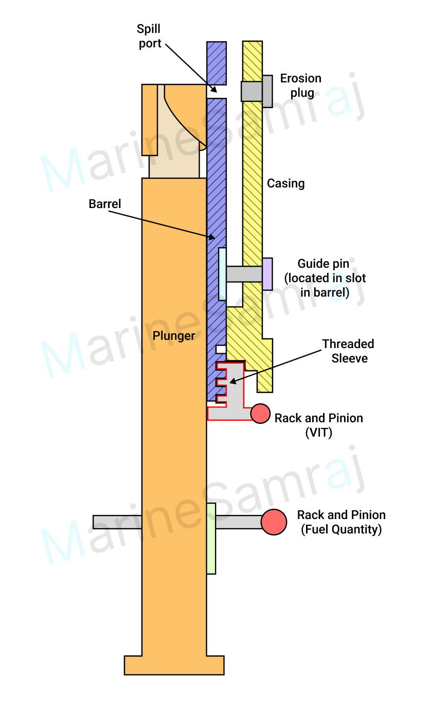

(b) Describe, with the aid of sketches a VIT fuel pump and explain how the change in timing is achieved whilst the pumps is in operation

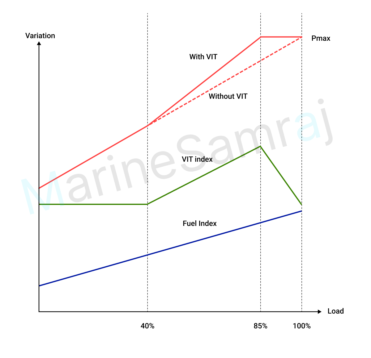

Variable injection timing (VIT) is a form of fuel pump control enabling an engine to operate with the designed maximum cylinder firing or combustion pressure from approximately 85% power output to maximum power.

Advancing the injection timing ensures the maximum cylinder pressure (Pmax) is reached at around 85% Maximum Continuous Rating (MCR), improving combustion efficiency and reducing fuel consumption.
