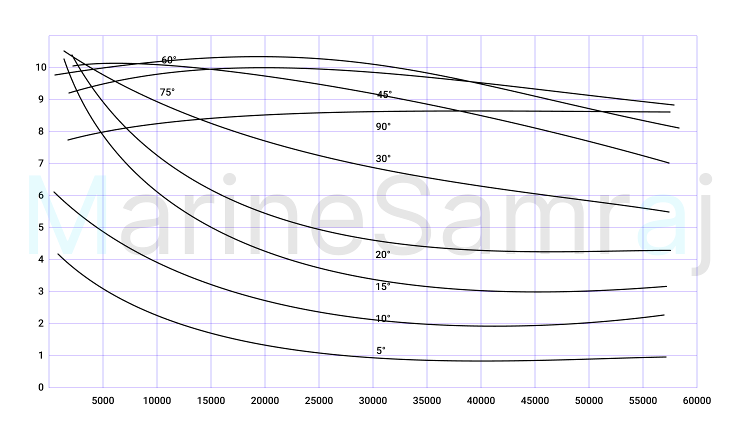

(a) KN curves are stability curves used in naval architecture. They are created by plotting the righting lever (KN) against the angle of heel (θ) for a given displacement and an assumed KG (height of the centre of gravity above the keel) of 0. The righting lever is the distance between the centre of buoyancy and the centre of gravity, measured along a vertical line through the centre of gravity.
The KN curve is then used to calculate the righting lever (GZ) for any other KG value using the following formula:
GZ = KN - KG * sin θ
Where:
