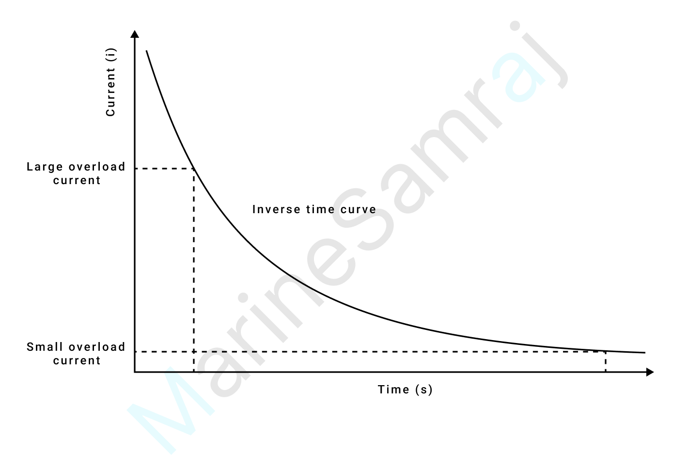

Explain three methods of overcurrent protection for electrical circuit. Explain with aid of diagram, the meaning of the term inverse current time characteristic. (8+8)
