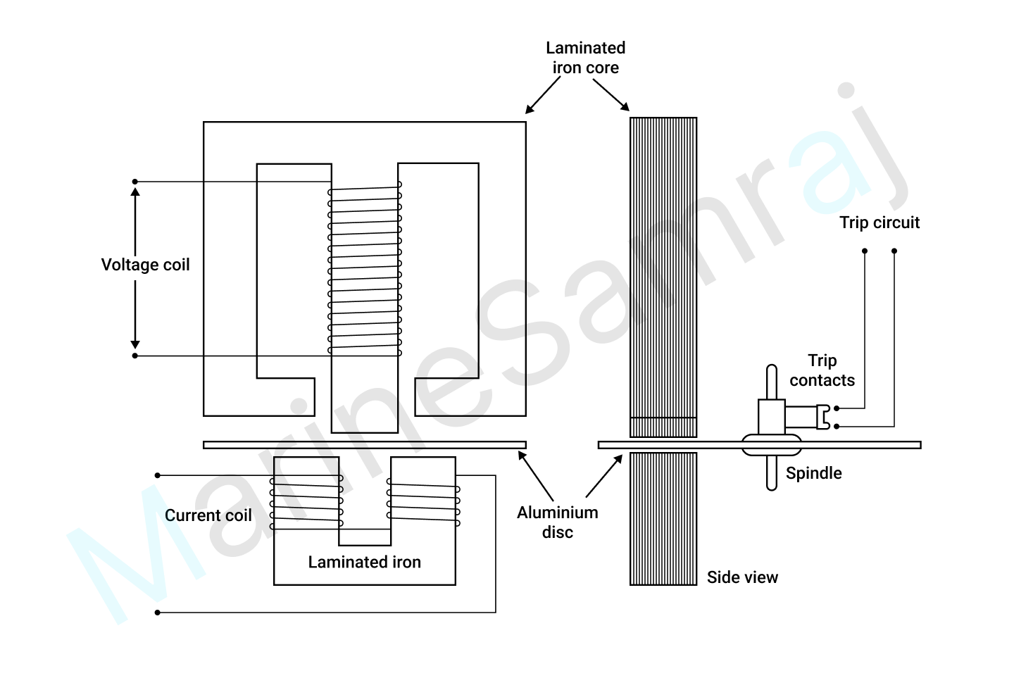

(b) (i) Sketch a reverse power trip.
(ii) Briefly explain the principle on which the operation of this power trip is based and how tripping is activated. (8)

To mitigate these risks, a reverse power relay is installed. This relay monitors the direction of power flow and trips the circuit breaker if reverse power exceeds a preset threshold (typically 10% of full load). The relay incorporates a time delay to prevent tripping due to transient conditions during synchronization or other short-term disturbances.
