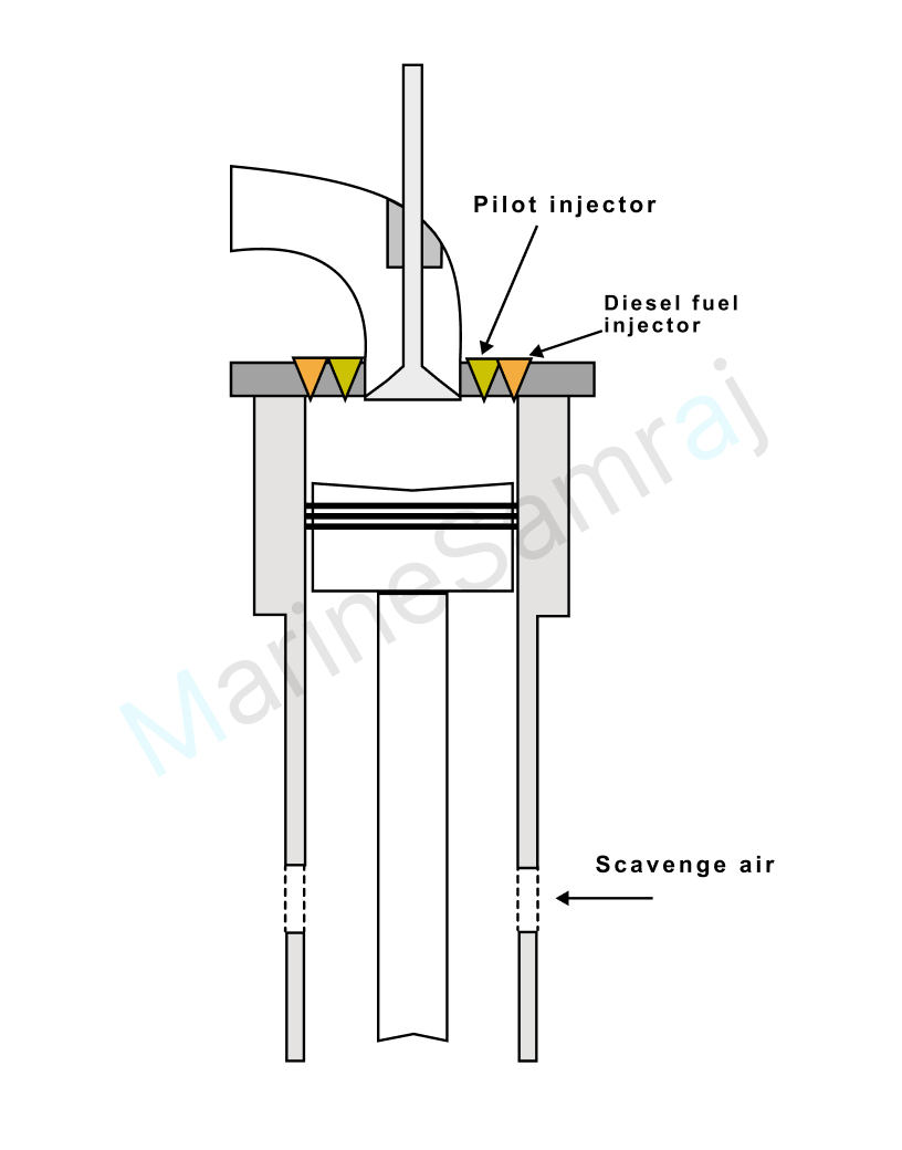

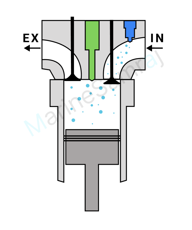

(b) Describe, with the aid of a sketch, the arrangements for a dual fuel engine which is capable of burning natural gas on:
(i) The Otto cycle
(ii) The Diesel cycle

(b) (i) Otto Cycle:
The engine operates in gas mode during the suction stroke, where a lean air-gas mixture is drawn into the cylinders.
The cylinder head is equipped with a gas admission valve positioned in the air inlet passage, and there is a fuel injector capable of both main and pilot injection.
