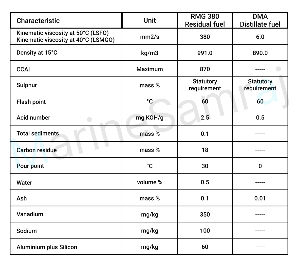

ISO 8217:2017
List of properties of LSFO and LSMGO
Fuel oil properties are explained below:
1. Viscosity: Measures the fuel's resistance to flow
