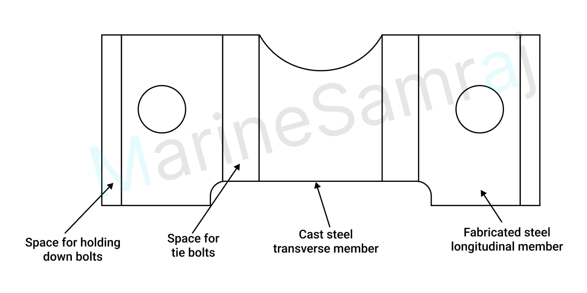

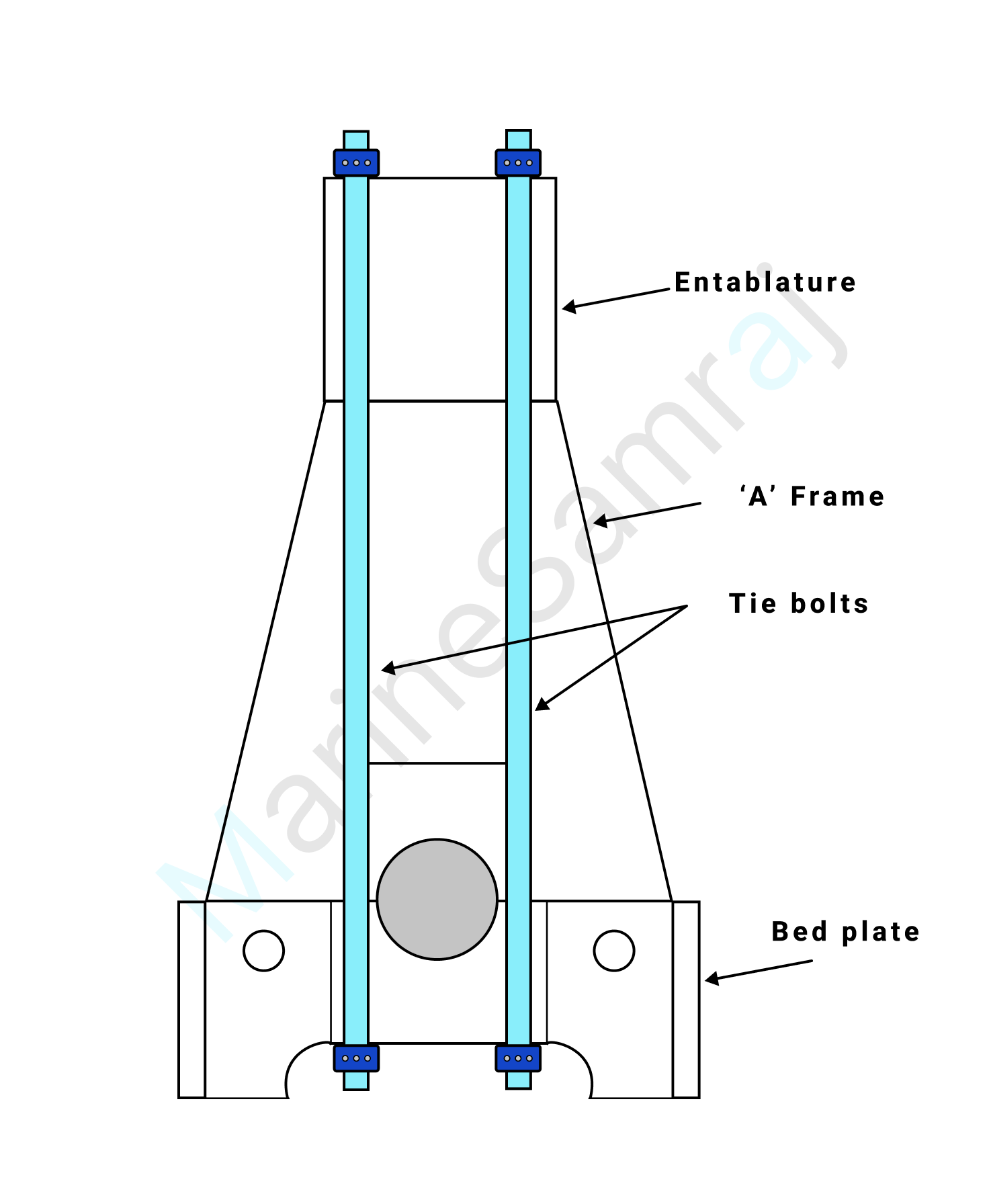

(a) Forces due to combustion load
Combustion forces exert alternating tension and compression loads on the engine structure.
These forces act on the piston, crankshaft, and bedplate.
The gas load is transmitted from the cylinder head through tie bolts to the bedplate .
