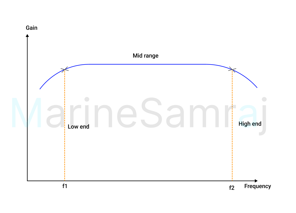

The frequency response of a transistor amplifier refers to how its voltage gain changes with signal frequency . Ideally, the gain should remain constant over the desired frequency range. However, in practice, the gain deteriorates at both low and high frequencies due to various circuit components and effects.
The two main factors that cause deterioration are:

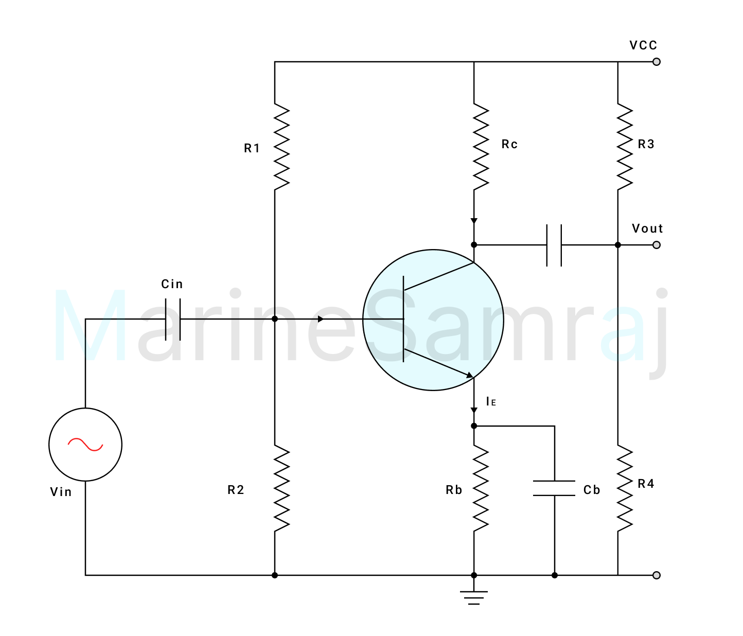

1. Coupling and Bypass Capacitors (Affecting Low-Frequency Response):
At low frequencies (below f₁, the lower cut-off frequency) , the following capacitive components contribute to the drop in gain:
