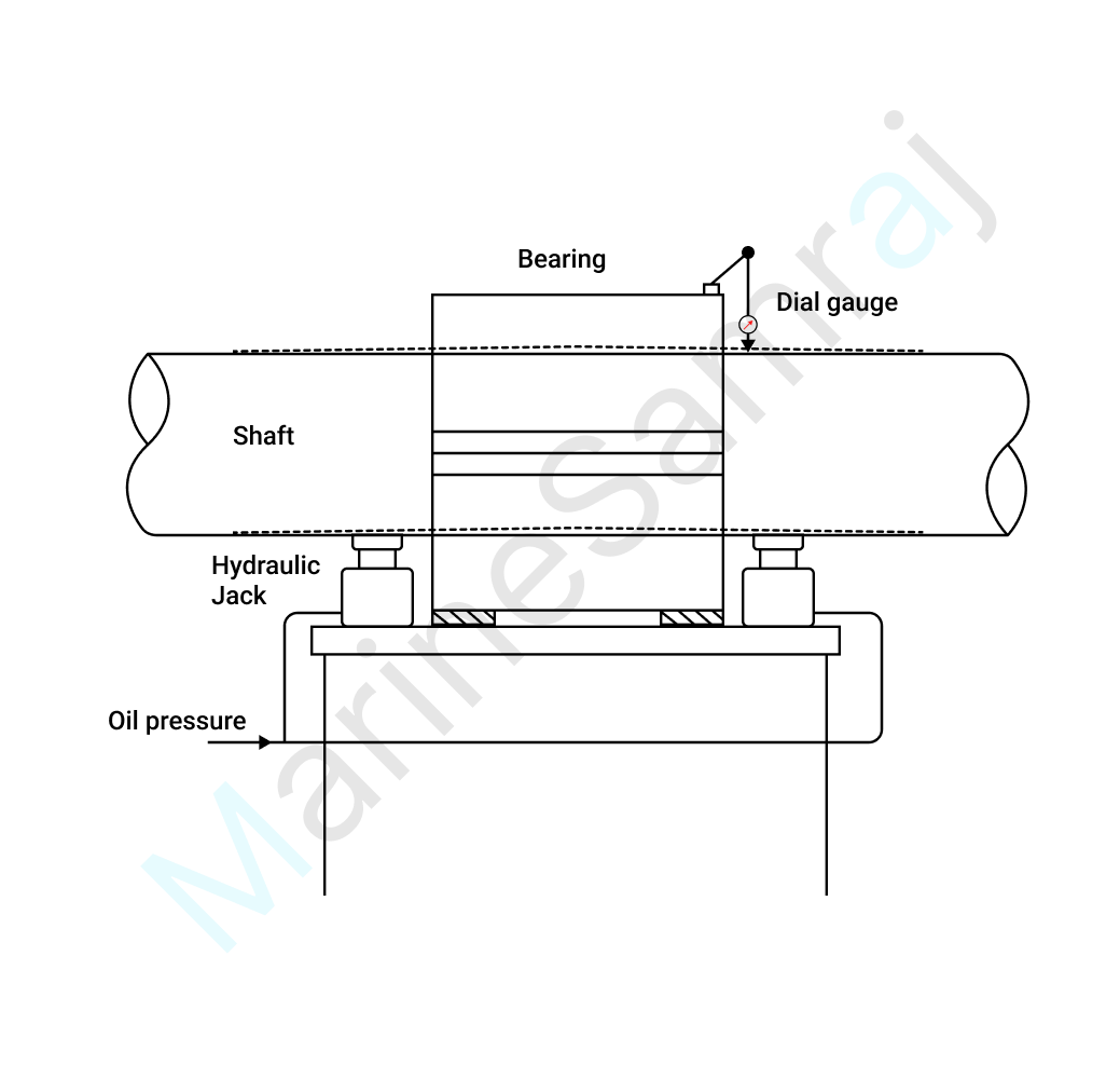

(b) Explain with a simple sketch how a bearing load is assessed (5)
