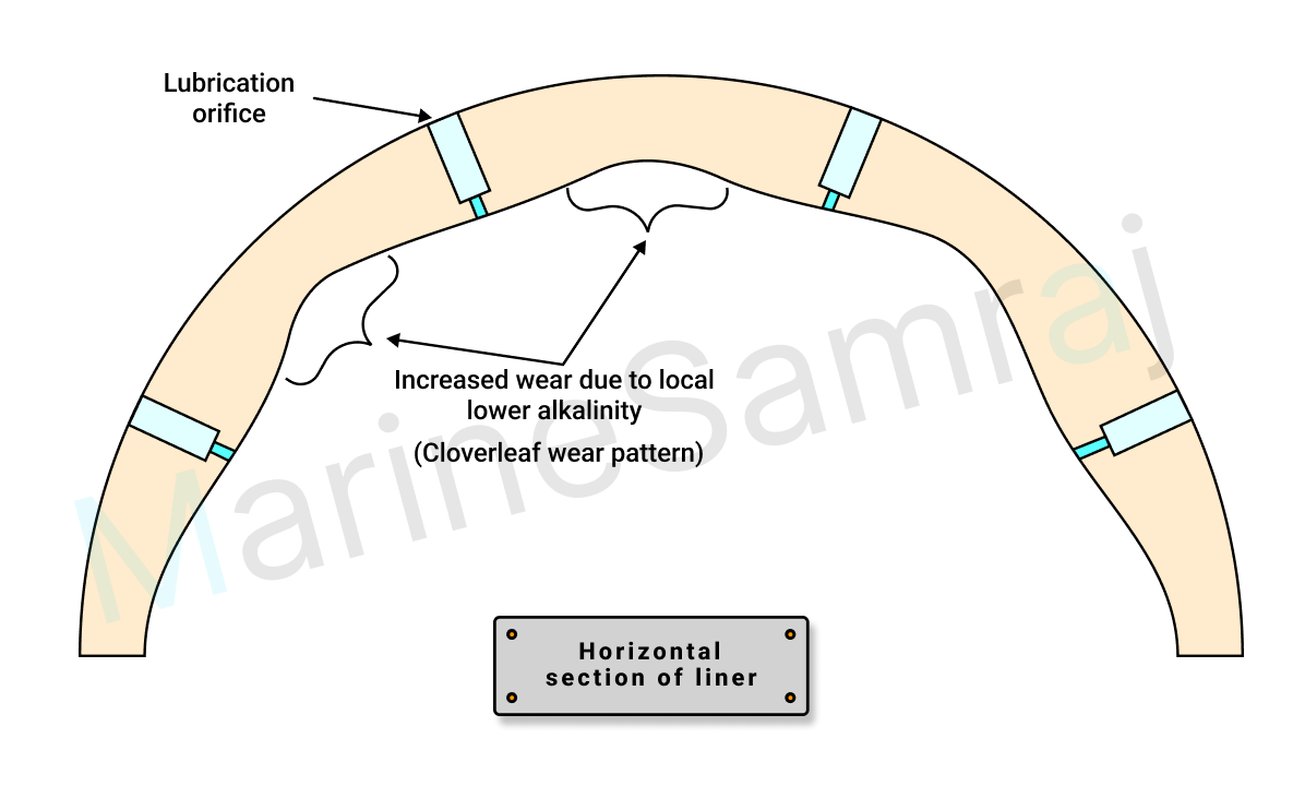

(b) What are the causes of cloverleafing and micro seizure. (5)
