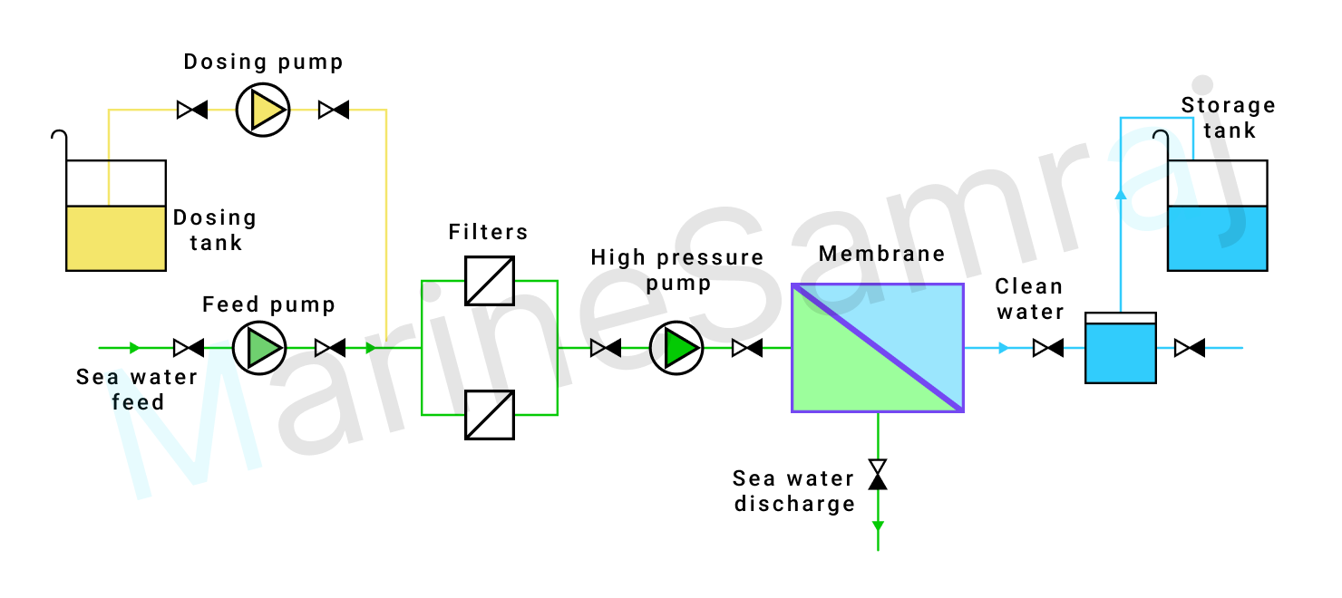

(b) Sketch a line diagram showing a single pass system for producing fresh water from seawater and describe the system. (8)
