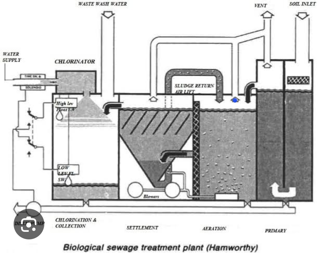

Q9 Sewage treatment plant is due for internal inspection. List in detail the procedure along with various parts to be included in the inspection and the safety precautions for carrying out the inspection of the STP. (16)
### Introduction
A thorough internal inspection of a Sewage Treatment Plant (STP) is a critical maintenance task governed by the Planned Maintenance System (PMS) and MARPOL Annex IV regulations. This procedure involves entry into an enclosed space with significant biological, chemical, and atmospheric hazards. Therefore, strict adherence to safety protocols is paramount. The inspection aims to verify the structural integrity, and the operational condition of all internal components to ensure the plant's effluent meets the required standards.
### A. Detailed Procedure for Internal Inspection
The procedure must be systematic and follow a strict sequence to ensure safety and thoroughness.
