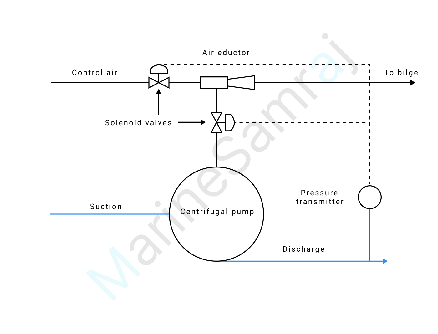

(b) Describe with aid of a simple sketch an air pump or primer used to initiate suction when the fire pump is situated above sea water level. What suction lift would you expect from a single stage pump system? (7)
