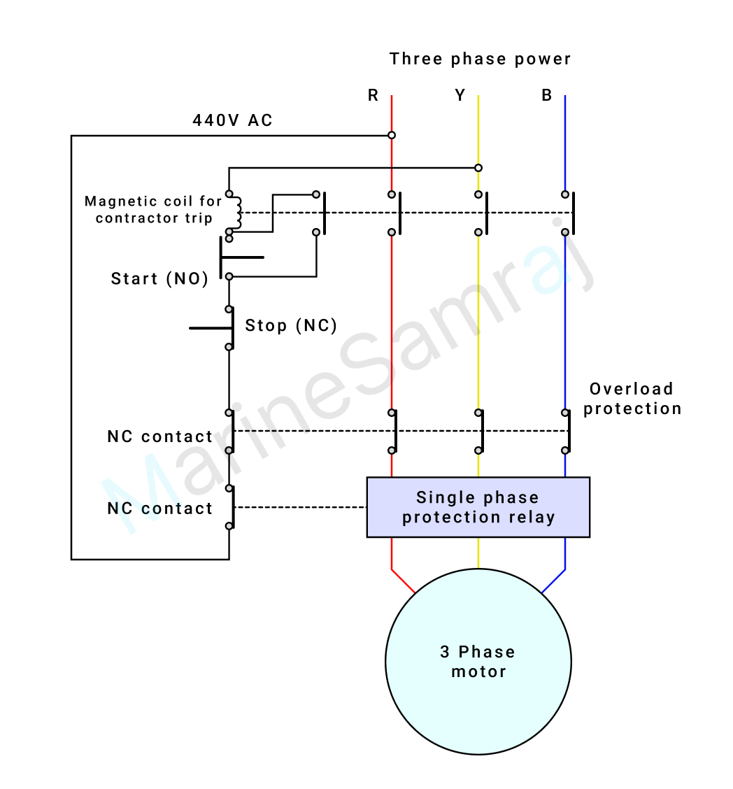

(a) Sketch a circuit diagram of a push button direct online contactor starter for a three phase Incorporating overload and short circuit protection. (8)

(a) In the D.O.L starter circuit:
The main supply is connected to the contactor, which, when energized, connects the A.C motor to the supply.
The START push button activates the contactor, allowing the motor to start running.
Overload protection (O/L Relay) and Single Phase Protection Relay are connected in series with the contactor in the control circuit.
