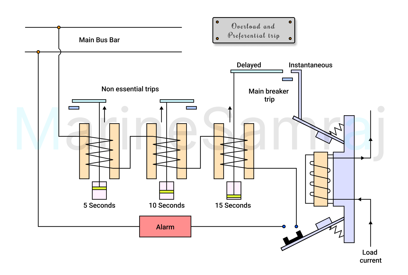

(b) With the aid of a sketch, outline the essential features of a three stage "preferential tripping" scheme for the main generators of a ship.
(b) Three-stage preferential tripping:
Preferential trips operate after a fixed time delay, causing non-essential loads to be shed.
When the generator load reaches 110%, preferential Trip comes into operation as follows
First Stage Preferential Tripping (PT1):
