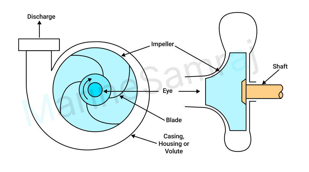

(a) Sketch a simple cross section through a single stage centrifugal pump with a fully shrouded single entry impeller, name the components of the pump and indicate the direction of fluid flow

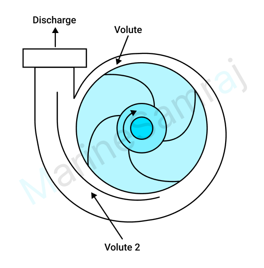

(i) A double volute casing

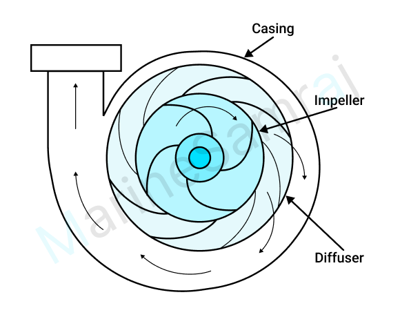

(ii) A diffuser ring
### (a) Cross Section of a Single Stage Centrifugal Pump
A sketch would show a cross-section of the pump casing with the impeller mounted on a shaft at its center. The fluid enters axially through the suction inlet and is discharged radially from the discharge outlet.
**Components to be Labelled:**
1. **Suction Inlet (Eye):** The central opening where the fluid enters the impeller.
