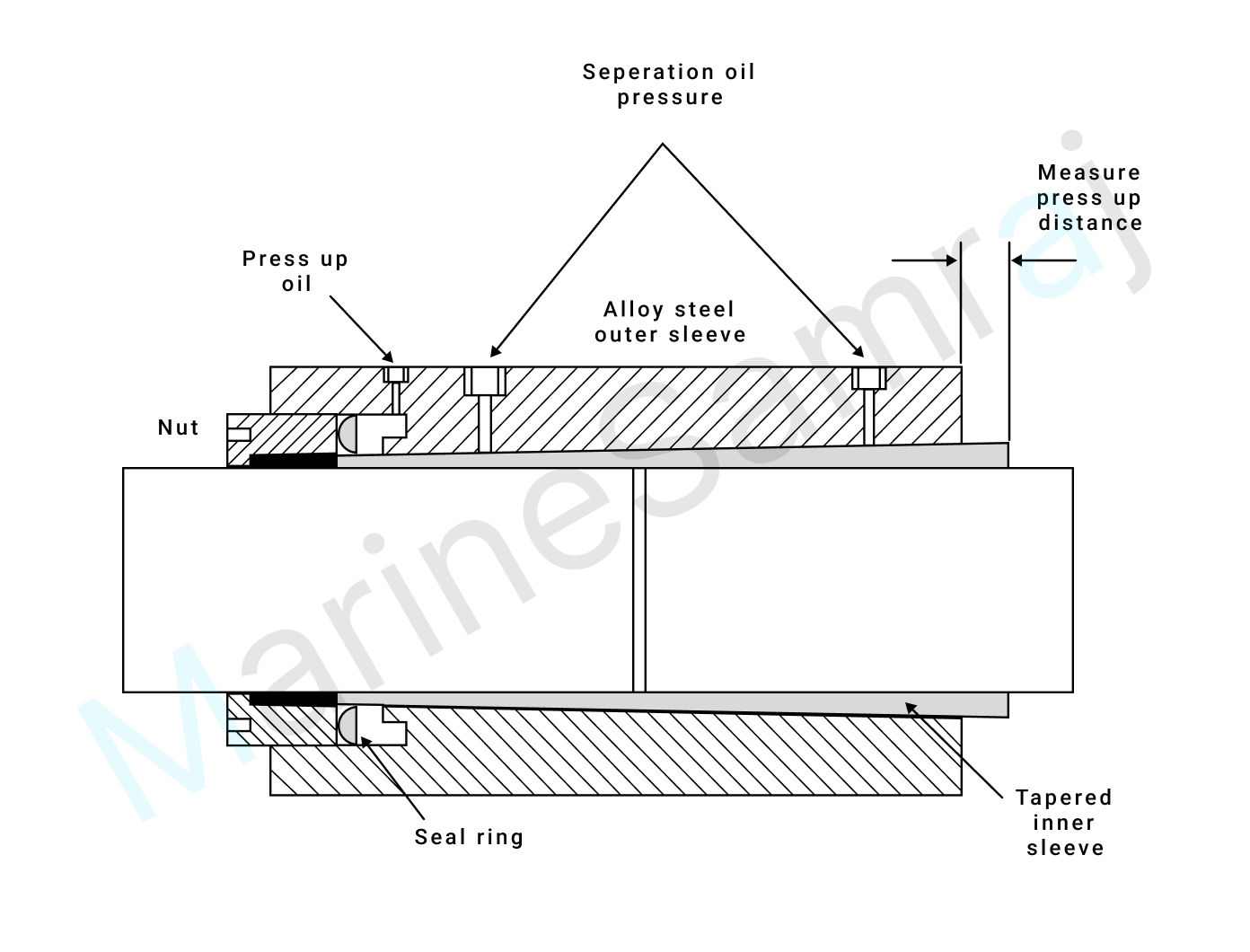

Sketch a transmission shaft coupling which enables the propeller shaft to be withdrawn outward.
(a) Describe a coupling and the method of fitting and withdrawing. (8)

A transmission shaft coupling that enables the propeller shaft to be withdrawn outboard (aftwards) is the hydraulic muff or sleeve coupling, such as the SKF type. This design provides a powerful friction grip without the need for keys or flanges, simplifying the shaft line and facilitating easier maintenance.
#### Description of the SKF Hydraulic Muff Coupling
This coupling is a keyless design that relies on the principle of oil-injection mounting. It is comprised of three primary components:
