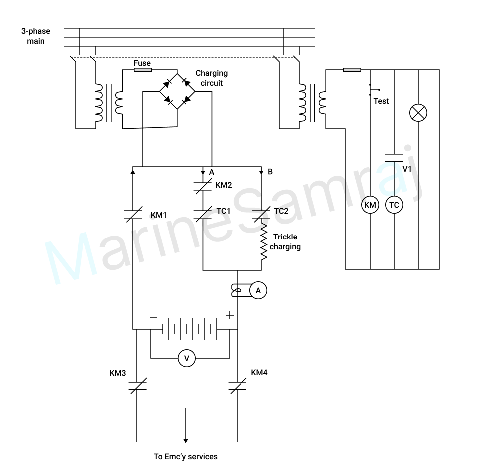

Sketch and describe an arrangement for automatic connection of emergency batteries upon loss of main power. Include in your answer:
(a) Means of obtaining d.c. charging supply from a.c. mains:
(b) A method of maintaining charge on lead acid batteries;
(c) The arrangement to check that batteries operate at loss of main power
(d) The length of time for which emergency batteries of passenger and cargo ships must provide power.
The DC charging supply is obtained from the main busbar. A transformer will step down the voltage to required charging voltage and a rectifier will provide DC voltage at required charging emf
When charging from a discharged state, emf is supplied through a branch ‘A’ at full charging voltage
A voltage monitor ‘V’ monitor the voltage of the cell and gets energised when cell its full charge emf of 2.2V/cell.
‘V’ closes contact V1 and energises contact ‘TC’, then TC 1 gets open and TC2 gets closed and current passes through a resistor for trickle charging.
